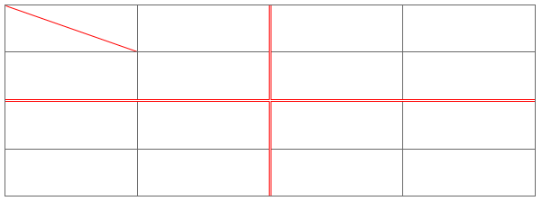

示例二
Dim
wdc
As
New
WordCreator()
Dim
tb
As
New
Word.Objects.RtfTable(4, 4)
'定义一个四行五列的表格
wdc.Add(tb)
'将表格添加到文档中
For
r
As
Integer
= 0
To
tb.Rows.Count - 1
'遍历行
For
c
As
Integer
= 0
To
tb.ColumnCount - 1
'遍历列
Dim
cell
As
word.Objects.RtfCell = tb.Rows(r).Cells(c)
'定义一个变量引用单元格
cell.SetRectBorder(Word.RtfBorderStyle.Single, color.DimGray, 1)
'设置默认边框
If
c = 1
Then
'设置第二列的右边框
cell.RightBorderColor = Color.Red
cell.RightBorderStyle = Word.RtfBorderStyle.Double
End
If
If
r = 1
Then
'设置第二行的底边框
cell.BottomBorderColor = Color.Red
cell.BottomBorderStyle = Word.RtfBorderStyle.Double
End
If
If
r = 0
AndAlso
c = 0
Then
'在第一个单元格显示一个斜线
cell.BackwardDiagonalColor = Color.Red
cell.BackwardDiagonalWidth = 1
End
If
tb.Rows(r).Height = 40
'设置行高
Dim
fl
As
String
"c:\temp\test.docx"
wdc.Save(fl)
Process.Start(fl)
生成的文档为:
